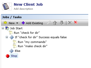

    While "run once" option is not available you may create a job which will check for something at the beginning and run other tasks depending of the result of the check. For example, if you may add dir-create operation in predefine path at the end of yuor script. Then create a job which will check for the dir existance as the first step. Then add condition which will and run required commands only if check for dir will fail. Such job migh run on re-occuring schedule, but commands will be executed only on the clients which are "new".
    1. How job might looks like:

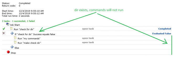

    2. Results of the first run:
    3. Re
    sults of the second run:
