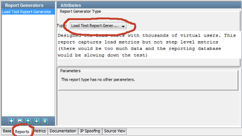

Reporting (Staging Documents)
Load Test Report Generator (Staging Documents)
Staging documents default to use a functional report generator that reports on events including information pertaining to each request / response.  Executing a performance test with staging documents set to functional reporting can add additional load into the database.  Use a report type of Load Test Report.

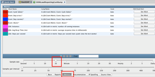

Metric Intervals
For large scale tests, set the metric interval to 30 seconds.  This means that every 30 seconds Simulators send their metrics to the Coordinator server.
