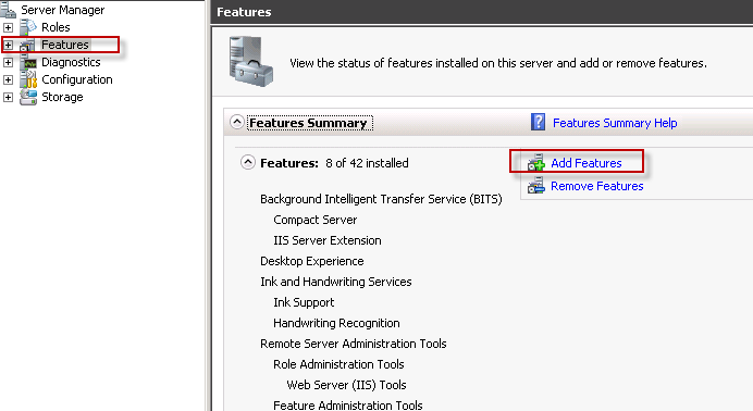

1. Open Server Manger - Start->Administrative Tools->Server Manager
2. Click on Features then Add Features

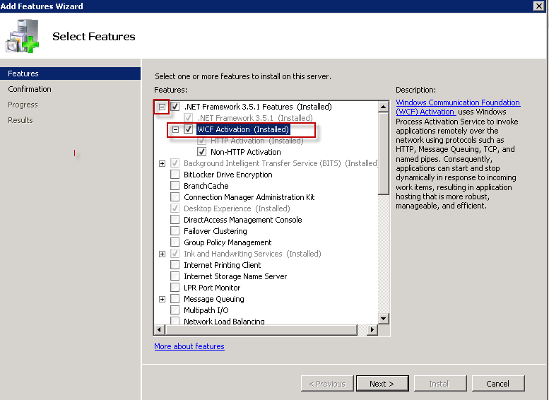

3. Expand .NET Framework 3.5.1 Features and check the box for "WCF Activation"
4. Click Next and then Install.

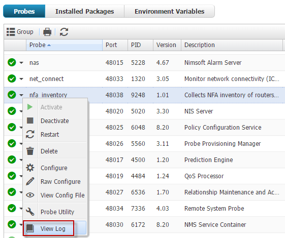

5. Once installed recycle the nfa_inventory probe in UIM and check to see that the error no longer appears.
