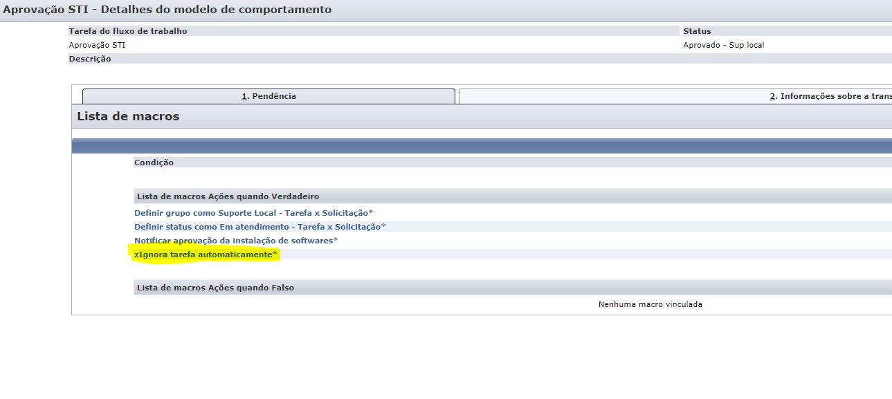

Hi guys,
Consider this scenario:
I have a request category with 3 classic workflow task attached:
So to do this I've followed this steps:
1) Put the file upd_val.spl in the folder $NXROOT/site/mods/majic;
2) Recycle spel_srvr or restart the ca sdm services;
3) Create an action macro using this code:
macro::upd_val("cr_wf",
format("cr = '%s' AND sequence IN (20, 30)", cr.persistent_id), // search over other tasks in the same parent request with seq 20, 30
1, 0, // delays
"status", "SKIP" // new status
4) Add this action macro to the status on task 10 that most be completed to skip the tasks 20 and 30;

Feb 02, 2018 04:52 AM
Hi Thiago,
well done on working this through, and apologies for not responding to your original request.
I hope you don't mind if I suggest a slightly simpler approach - this may also help with other things that you do with classic workflow.  The way I'd be inclined to do this is to put a 'behavior' against the Pending status on task 200 in your template:
For this behavior the condition macro 'zWf100APP' is coded as follows.  Use type = COND rather than COND_SITE, to avoid issues if you later update the name or status of the macro through the UI:
// Updated to make this appropriate for a Req/Inc/Prb workflow task
string method; method="zWf100APP";
string theCR;
theCR = this.cr;
// Look up task 100 from the cr id.
send_wait(0, top_object(), "call_attr", "cr_wf", "sync_fetch",
"RLIST_DYNAMIC", format("cr=%d and sequence=100 and status='APP'", theCR), -1, 0);
if (msg_error())
   logf(ERROR, "%s: Error on sync_fetch for %s WFs: '%s'", method, theCR, msg[0]);
   return;
object wf_list;
int wf_count;
wf_list = msg[0];
wf_count = msg[1];
logf(TRACE, "%s - %d recs found for cr %d", method, wf_count, theCR);
if (wf_count > 0)
   // Have at least one task 100 with status APP (in reality of course there can only be one)
   set_return_data(TRUE);
else
   set_return_data(FALSE);
The 'Action on True' Action macro 'Set WF SKIP' is coded as follows:
// Set task status SKIP
this.status="SKIP";
You can follow this in task 300 with a similar Behavior.
