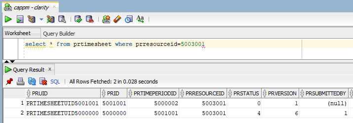

    You're correct in that timesheets that haven't yet been initiated (by clicking on the clockface) do not yet exist in the database - so they don't have rows in the prtimesheet table in the transactional database, and hence they don't appear in the data warehouse database.
    In my system I have 3 timesheets for myself, 2 of which are "open":
    In the database though only the final two shown above actually exist:
    You'd have to generate the "missing" rows in prtimesheet . I'm sure someone can come up with a better bit of SQL but one way is as follows (where you'd inject the 5003001 value as a parameter in the real world):

    We now see the missing timesheet too:
