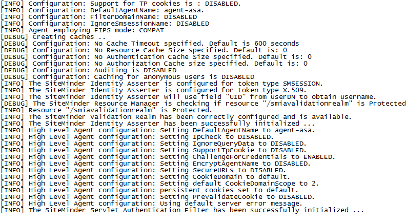

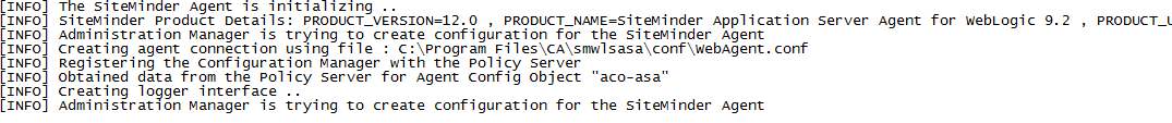

5. Review the ASA logs and ensure the agent is initialized with no error (you will need to configure logging if not already configured : Configure SiteMinder Agent Log Files - CA )
    sample working logs :
    SiteMinder Agent Provider log:
    SiteMinder Agent connection log:
