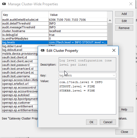

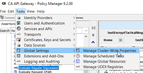

1. Edit Cluster wide settings :
Add entries to set STDOUT and STDERR logging level to FINE in the log.levels key:
Added each on separate line in the value part.

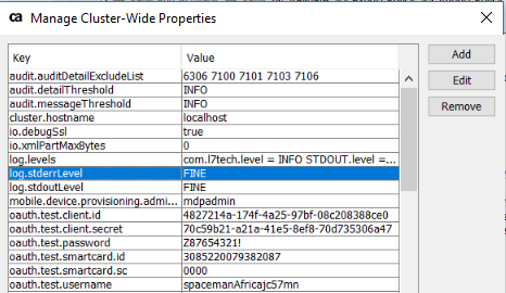

Add log.stderrLevel = FINE and log.stdoutLevel=FINE to cluster wide properties:

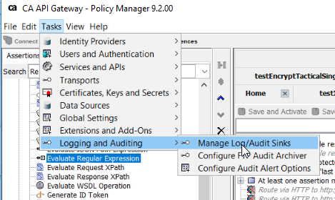

2. Add stdout/stderr log:
From the menu pick the Logging / Manage Log menu item :
Then "create" a new log with name stdout, type File, that matches the logs for packages STDOUT and STDERR.
The packages are added via Add Filter, selecting Filter Type then entering STDOUT and STDERR.

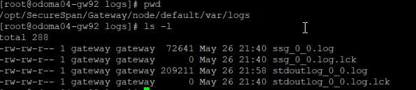

4. Check for the logs
Logon to  the the gateway, check the directory /opt/SecureSpan/Gateway/default/var/logs
There should be a new stdoutlog_0_0.log
Generally it will be zero length, unless you have something that explicitly writes to the System.out  and System.err.  That may be the SSL debug as described in the documentation, or a custom module, or as per the referenced link the CA SSO module.
