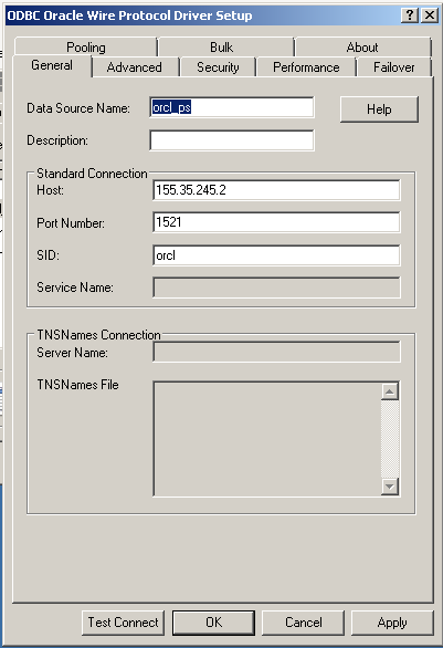

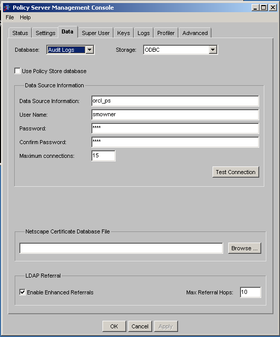

  1. Configure Policy Server to Audit Database Connection in Policy Server Management Console.

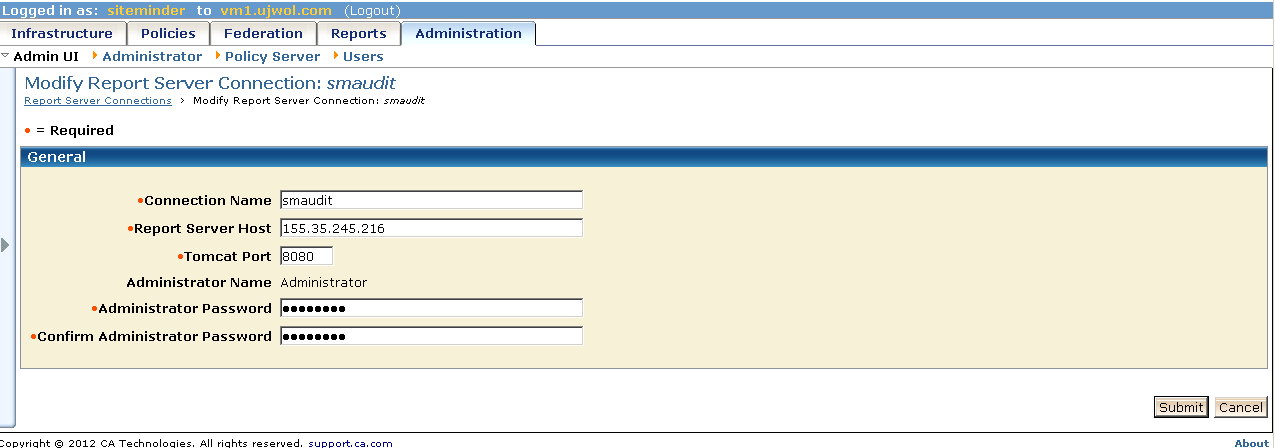

  2.  Configure WAMUI to Report Server Connection

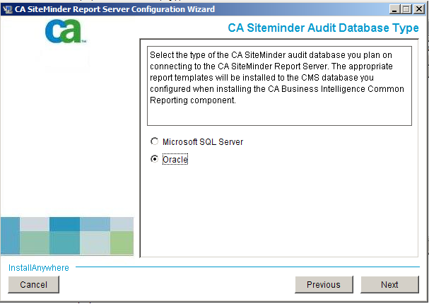

  3.  Run report server configuration wizard and select correct audit database type.

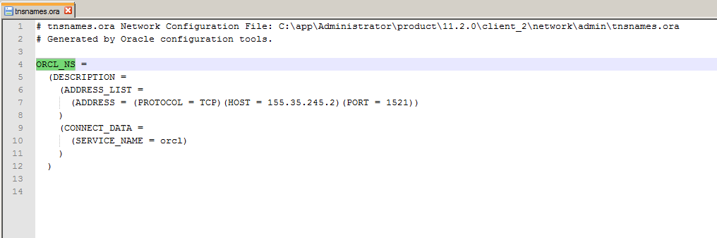

  Verify “tnsname.ora” file located at :  $Oracle Net Client home$\network\admin
  1. e.g.
    C:\app\Administrator\product\11.2\client_2\network\admin
    Here, Net Service Name = ORCL_NS & Service Name = orcl

6. In WAMUI, create Audit report connection
Name = any connection name
DSN = “Net Service Name” configured in tnsname.ora file in Report Server host.
Service Name = “Service Name” configured in tnsname.ora file in Report Server host.
