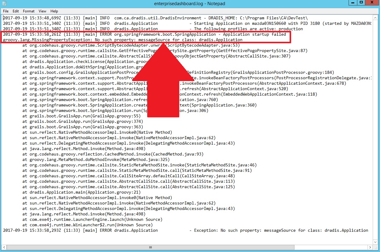

Issues with the license key files can show up in many ways. Let’s look at your log files to dig deeper. Navigate to the LISATMP directory, which defaults to C:\Program Files\CA\DevTest\lisatmp_<version> in Windows.
Do see the below error when starting the Enterprise Dashboard in enterprisedashboard.log? This error indicates that your license key is expired.
2017-09-19 15:33:58,261Z (11:33) [main] ERROR org.springframework.boot.SpringApplication - Application startup failed
groovy.lang.MissingPropertyException: No such property: messageSource for class: dradis.Application

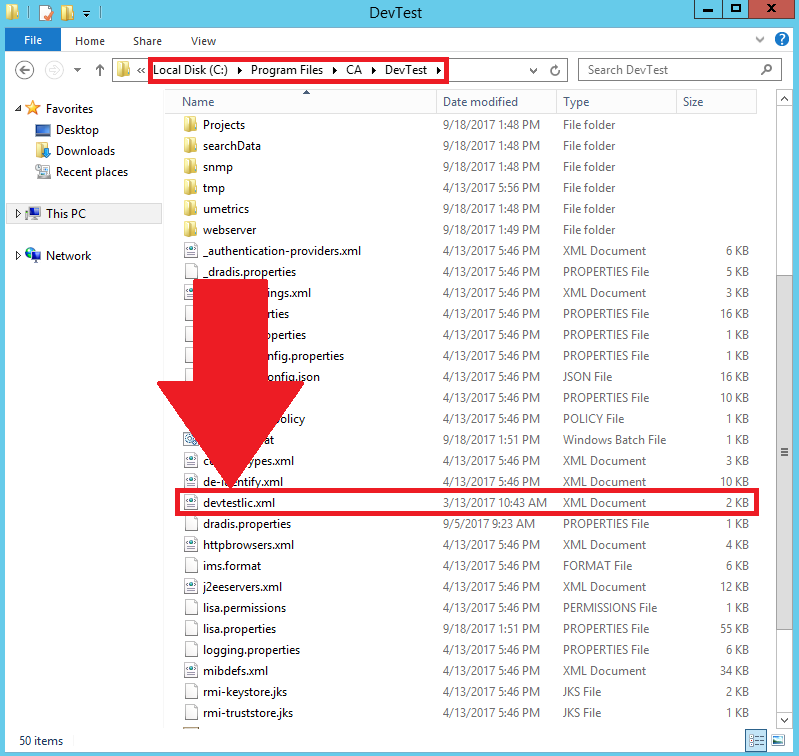

You can find your license key in the DevTest installation directory (a.k.a., LISA_HOME) where the Enterprise Dashboard is installed, which in Windows defaults to C:\Program Files\CA\DevTest. In this directory is a file called devtestlic.xml.

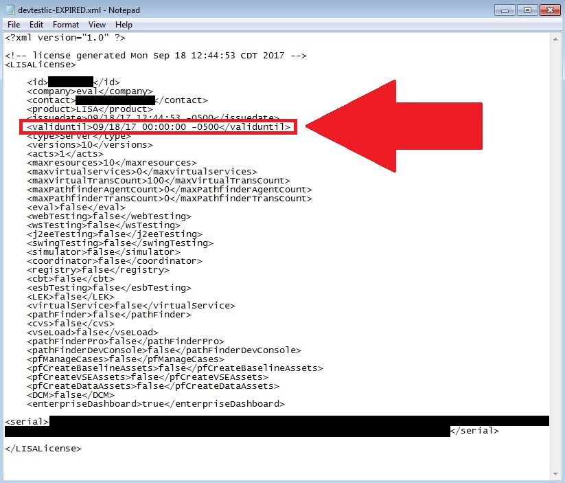

The license key file can be opened in Notepad or another text editor. Here's an example of my license key file. Yours may look slightly different. Note the <validuntil> date. Your license will expire on this date. You need to renew your maintenance contract and request a new license key file from Support before this date.
Once you have the new license key file, you can replace the existing license with your new license and restart all DevTest services to activate the new license. Do not change the file name and be sure to stop and start all DevTest services in the correct order.
