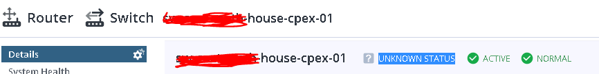

    Hi,
    I am having an issue where a couple of devices are discovered in the Performance Management, where they are contactable via ICMP and SNMP from Performance Center but when i navigate to the device to pull "reachability" statistics. No data is shown. The Device "reachability" status is showing "unknown status" when on device details page.
    The work around that i found was 'deleting' the device then discovered it again in the system. This i tested with a couple of devices, however i loose all previous statistics for that device. Could anyone advise another workaround to resolving this "unknown reachability status"?
    fyi, i tried rediscovering, but that didnt work.
    Regards,
    Raz

    Best Answer
    Posted Mar 02, 2021 09:35 AM
     Hi Bruno,
    I found a way to fix it, so if you find yourself in the same boat here is the steps i did to resolve. *actually simple* xD
    Go to Administration/Monitored Item Management/Monitored Devices/
           - Search and select the device affected
           - Under details tab, click on "stop polling"
           - wait a poll cycle
           - then "start polling"
           - wait another poll cycle
           - confirm in inventory list if the unknown status has changed to reachable.
    It will then start collecting the reachability statistics.
