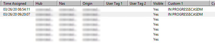

When an alarm is raised and this alarm is asigned to defined user, the system trigger the incident creation, on custom fields the systems puts the legend "In progress CASDM" as shown in the image:
