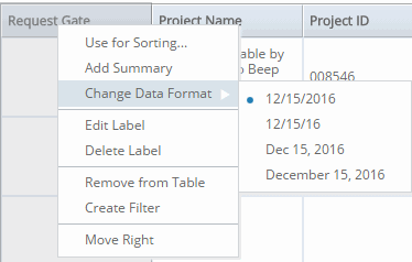

    Out of the box domain based attributes allow date format to be set to mm/dd/yyyy format like below

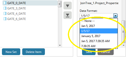

    However a simple custom domain based attribute does have only mm/dd/yy as an option on reports as well as in the domain designer.
    This limits the use of date formatting as PPM in our case is set to mm/dd/yyyy and that is what users want to see.

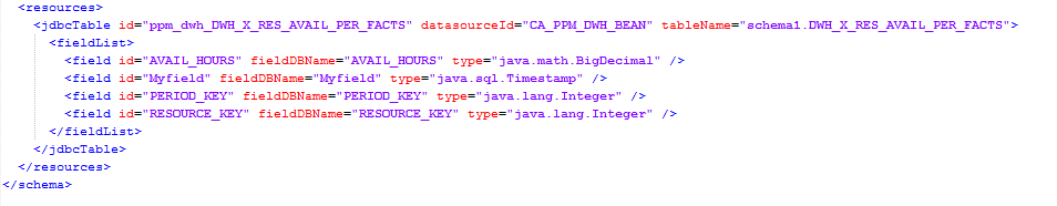

    1. Open the file inside schema.xml.data with a Text Editor
    2. Find the business date fields you need to reset and set them to java.util.Date instead of java.sql.Timestamp
      Here is an example:
    Important! Do not set any system dates, only the business dates in CA PPM. Internal dates should remain as timestamp. (Example dw_updated_date should be a timestamp)
