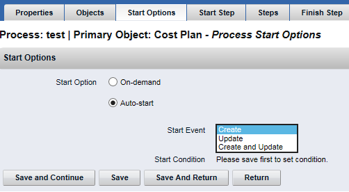

If you want to start a process related to a cost plan, your choices are:
- Start process on creation of a new plan
- Start process on update of an existing plan
- Both of the conditions above - create and update
These options are visible when you create a new process, associate that process to the cost plan object, and click the "Start Options" tab:
I hope this clarifies things!
