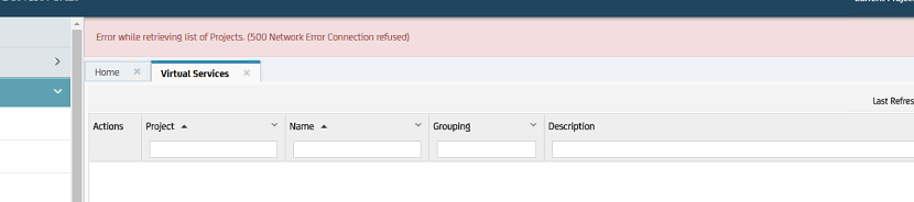

    We have created docker images in Kubernetes Orchestration Engine for all DevTest components and deployed into Linux VM machines but we  are getting error on the portal console.
    The error message is " Error While retrieving list of Projects ( 500 Network Error Connection refused) "
    Error while retrieving list of Projects. (500 No JSON Formated Retrofit Error <html> <head> <meta http-equiv="Content-Type" content="text/html;charset=utf-8"/> <title>Error 500 Server Error</title> </head> <body><h2>HTTP ERROR 500</h2> <p>Problem accessing /res-hub/v1/projects. Reason: <pre> Server Error</pre></p><h3>Caused by:</h3><pre>java.lang.RuntimeException: java.lang.NullPointerException at com.ca.devtest.acl.servlet.filters.RemoteAuthenticationFilter.doFilter(RemoteAuthenticationFilter.java:242) at org.eclipse.jetty.servlet.ServletHandler$CachedChain.doFilter(ServletHandler.java:1676) at org.springframework.web.filter.OncePerRequestFilter.doFilter(OncePerRequestFilter.java:101) at org.eclipse.jetty.servlet.ServletHandler$CachedChain.doFilter(ServletHandler.java:1676) at org.grails.web.servlet.mvc.GrailsWebRequestFilter.doFilterInternal(GrailsWebRequestFilter.java:75) at org.springframework.web.filter.OncePerRequestFilter.doFilter(OncePerRequestFilter.java:107) at org.eclipse.jetty.servlet.ServletHandler$CachedChain.doFilter(ServletHandler.java:1676) at

    Yes Portal is running on its own container,  and the portal logs shows
    Caused by: java.net.ConnectException: Connection refused      at java.net.AbstractPlainSocketImpl.doConnect(AbstractPlainSocketImpl.java:350)      at java.net.AbstractPlainSocketImpl.connectToAddress(AbstractPlainSocketImpl.java:206)      at java.net.AbstractPlainSocketImpl.connect(AbstractPlainSocketImpl.java:188)      at java.net.SocksSocketImpl.connect(SocksSocketImpl.java:392)      at java.net.Socket.connect(Socket.java:589)      at com.squareup.okhttp.internal.Platform.connectSocket(Platform.java:100)      at com.squareup.okhttp.Connection.connectSocket(Connection.java:196)      at com.squareup.okhttp.Connection.connect(Connection.java:172)      at com.squareup.okhttp.Connection.connectAndSetOwner(Connection.java:367)      at com.squareup.okhttp.OkHttpClient$1.connectAndSetOwner(OkHttpClient.java:128)      at com.squareup.okhttp.internal.http.HttpEngine.connect(HttpEngine.java:328)      at com.squareup.okhttp.internal.http.HttpEngine.sendRequest(HttpEngine.java:245)      at com.squareup.okhttp.internal.huc.HttpURLConnectionImpl.execute(HttpURLConnectionImpl.java:438)      at com.squareup.okhttp.internal.huc.HttpURLConnectionImpl.getResponse(HttpURLConnectionImpl.java:389)      at com.squareup.okhttp.internal.huc.HttpURLConnectionImpl.getResponseCode(HttpURLConnectionImpl.java:502)      at retrofit.client.UrlConnectionClient.readResponse(UrlConnectionClient.java:73)      at retrofit.client.UrlConnectionClient.execute(UrlConnectionClient.java:38)      at retrofit.RestAdapter$RestHandler.invokeRequest(RestAdapter.java:321)
