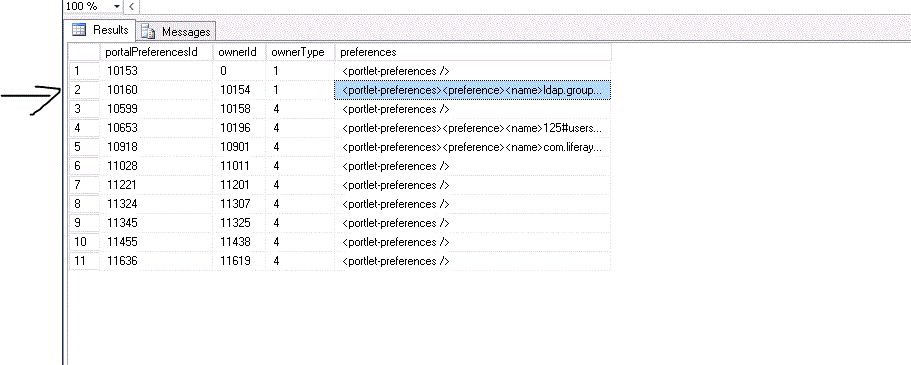

    Are you using SQL Server/Oracle for the underlying USS database?  Or  MySQL?
    Authentication preferences are stored in one attribute of  PortalPreferences table.  Example: See the preferences here for one USS Portal instance

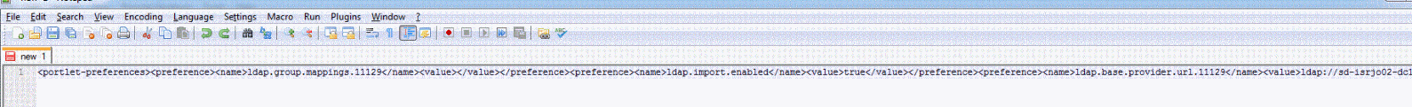

    So if you want to search for a specific value there for a specific preference (ex: EEM Server name), then you would end up Copy/Pasting that record result  into Notepad++  Now it looks like below.  Still not of good usebad.GIF

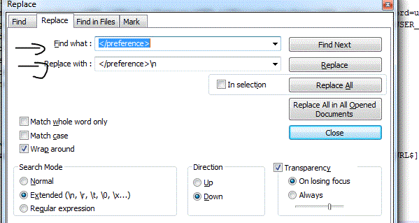

    So Invoke the Replace feature of Notepad++  via Edit -> Replace  and use below syntax (Note:   The Search Mode is set to  Extended)
    What this does is,  for every </preference>  its  inserting a  New Line character after </preference>
