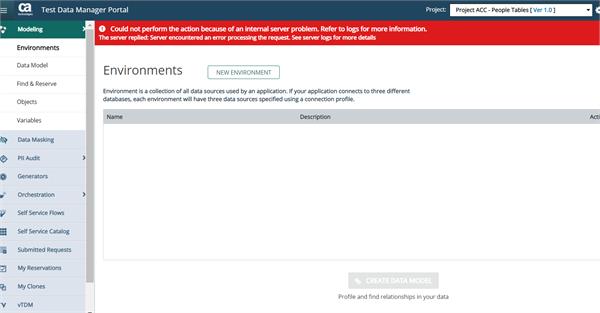

Sent: 01-15-2021 06:20 AM
From: Ramalakshmi Sugavanam
Subject: Error in TDM Portal
Hi,
I see the below error all of a sudden under "Environments" and the environment which was created also not showing up here. How can i proceed here?
I am trying to create self-service catalog. But struck with this one. Kindly help
Could not perform the action because of an internal server problem. Refer to logs for more information.The server replied: Server encountered an error processing the request. See server logs for more details
