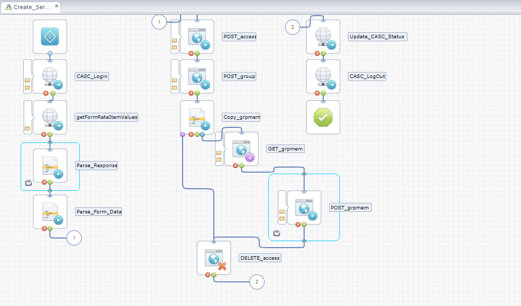

    1. Import "PAM_Process_Create_Service_Desk_Group.xml" to your PAM library to a folder of your choosing.

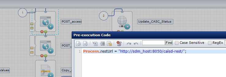

    2. Check out the process and navigate to the POST_access operators pre-execution code and update the Process.restURL variable.  Set this variable to your service desk servers rest endpoint. Leave the end format of the URL as is, the other operators add their respected objects onto the end of the URL.
    3. Make sure you have a valid userID__ and password__ set in the "/CA SDM/SDM_GlboalDataset" dataset. The POST_access operator queries this info.  If you don't use this dataset override the "User name" and "Password" used in the Post_access operator.
    4. Make sure you have a valid userID__, password__, and businessUnit__ set in the "/CA SLCM/SLCM_GlboalDataset" dataset.  The CASC_Login operator queries this info.  If you don't use this dataset override the "User name", "Password" and Business Unit used in the CASC_Login operator.
    5. Save and Check In the process.

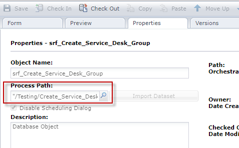

    6. Import "PAM_Start_Request_Form_srf_Create_Service_Desk_Group.xml" to your PAM library to a folder of your choosing.
    7. Check out the start request form and update the Process Path to point to the process that was imported in step 1.  Save then Check In the SRF.

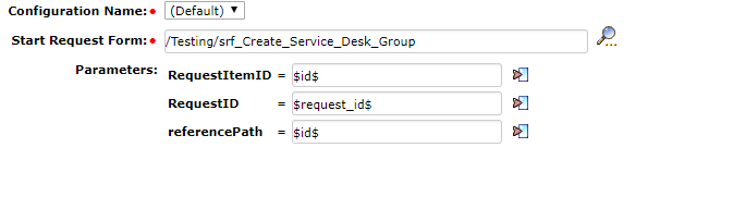

    c. Launch PAM SRF
    12. Edit the "Launch PAM SRF" action and update the path for the start request form.  Press OK.

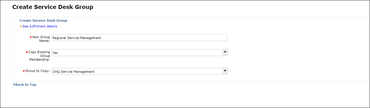

    Service Catalog Form

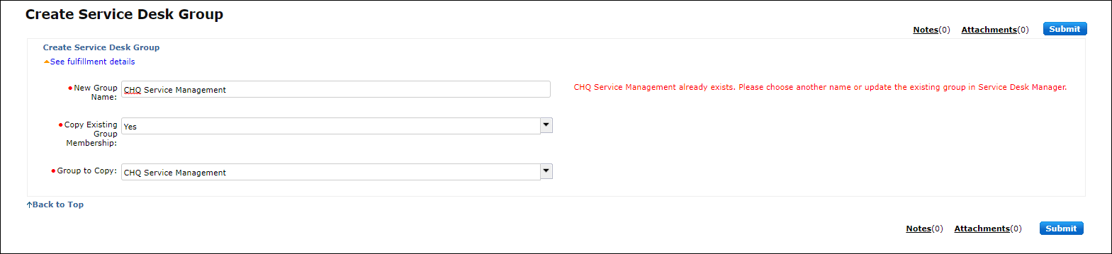

    On Submit logic stops you from submitting the form if the New Group Name already exists in SDM.
    PAM process uses the SDM Restful API
