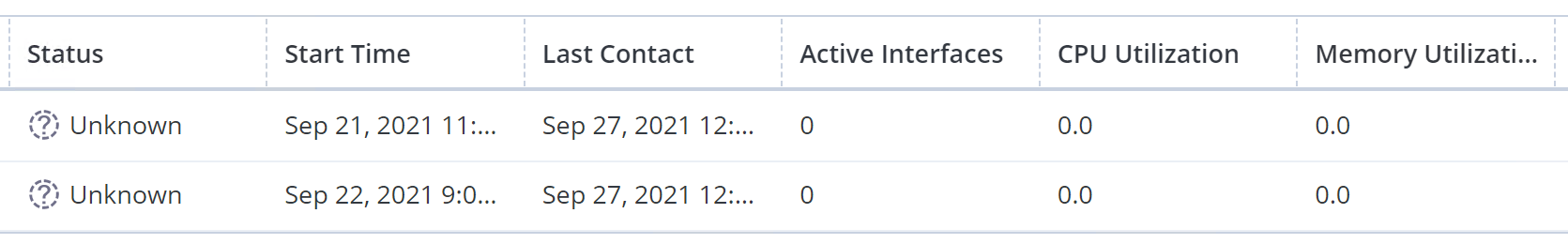

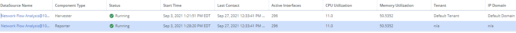

    I see this in the Portal (PC 20.2.4) System Status page. NFA (21.2) is running and shows available in Data Sources. The start time is the when NFA was I enabled SNMP with a proper community string. What is the source of this status? What is it looking for?

    I think you need to update PC also to 21.2.
    21.2 docs indicate to update the entire NetOps environment to 21.2.x when upgrading.
    There are probably changes in PC to go along with the NFA changes for the System Status page.
    Status should be coming from NFA odata call being made by PC.  But then we convert to displayable value like below.
    PC may be failing to make the odata API call to NFA or other error with processing the results.
