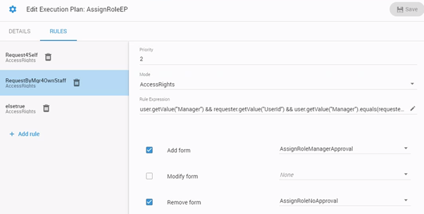

I have not performed this task myself, but based on your description it seems like you are running into a permissions scope issue.
have you test removing a role from the manager as the manager? if so that would be the same use case as the employee removing the role itself.
Did the manager assign the role to the user? can you try with assigning the role to the user as the manager then try to remove as the manager?
Also, if this is possible, then it would just point to scoping of either the role assigned or the user being managed.

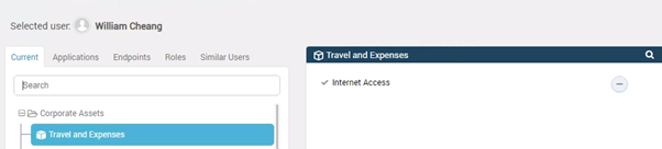

Hi Team,
CA Identity Portal 14.3 (vapp)
When login as myself, I can request to remove my own Internet Access", where it show the "-" remove button which is working fine.
But when I login as Manager(jonri01), then search my staff(who is "William Cheang"),
Then manager can not see the remove "-" button
This is my Execution Plan, anything wrong with my execution plan ? Why manager can't see the "-" remove button ?
