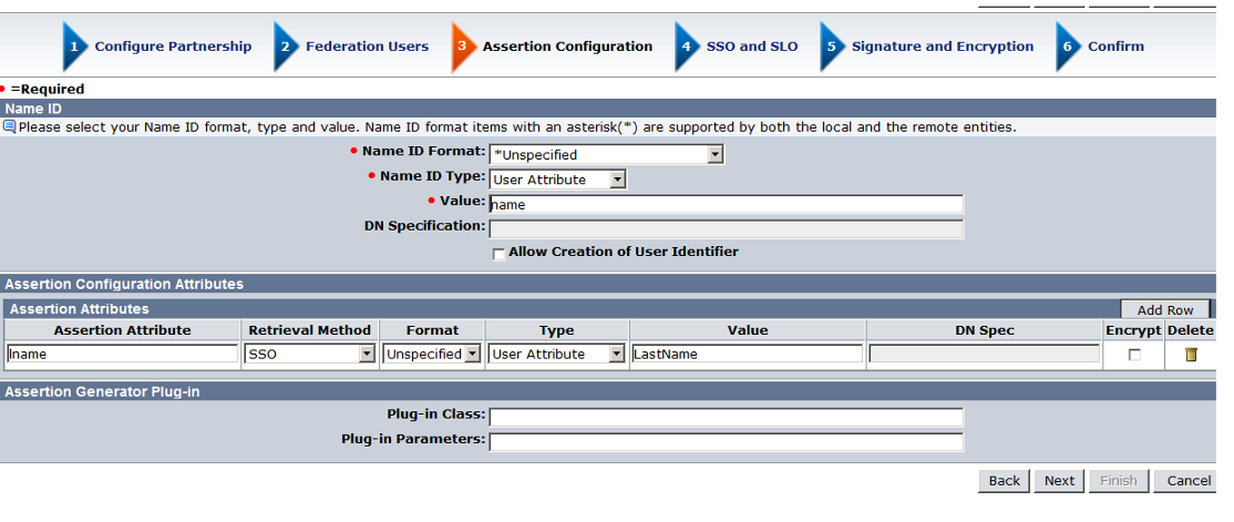

    If you want to include additional attributes, you will have to modify the Partnership on the IDP and add the attributes you would like to be sent to the agent:
    For example:
    => Screenshot of Partneership -> Assertion Configuration -> Assertion Attributes
    In the above, I have included an assertion attribute(lname) of type user attribute and gave it a value of LastName.
    The result is that, this assertion attribute is sent to the client as below:
    HTTP_AUTHNCONTEXT urn:oasis:names:tc:SAML:2.0:ac:classes:Password
    HTTP_FORMAT urn:oasis:names:tc:SAML:1.1:nameid-format:unspecified
    HTTP_NAMEID Robm
    HTTP_LNAME Moore
