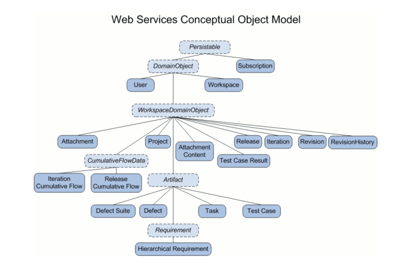

    Seeing that User Stories (AKA Hierarchical Requirements) and Defects are both descended from the proto-type Artifact, I had hoped I could query against Artifacts and get objects of either type that met the criteria.  Both Defects and User Stories have an Iteration field.  I hoped to ask for all Artifacts contained in particular Iteration.

    Hi Michael,
    Both Defect and HierarchicalRequirement inherit from SchedulableArtifact before Artifact and that is where the Iteration attribute is first introduced. So your query will work if run for SchedulableArtifact.

    Posted Sep 13, 2017 10:00 PM
    Awesome, Sean.  Thanks.  Didn't see that object in the pictorial model, but do when I manually walk the inheritance link chain upwards in the web services API docs.   Much appreciated.
