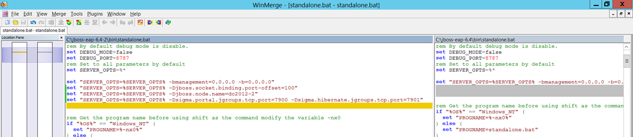

        - The standalone.bat was updated with additional JVM options to assist with the port offset for the 2nd JBOSS.
        -  Updated node name entry to avoid collision.
         - Path in the standalone.xml file were updated as needed, to reflect relative paths.

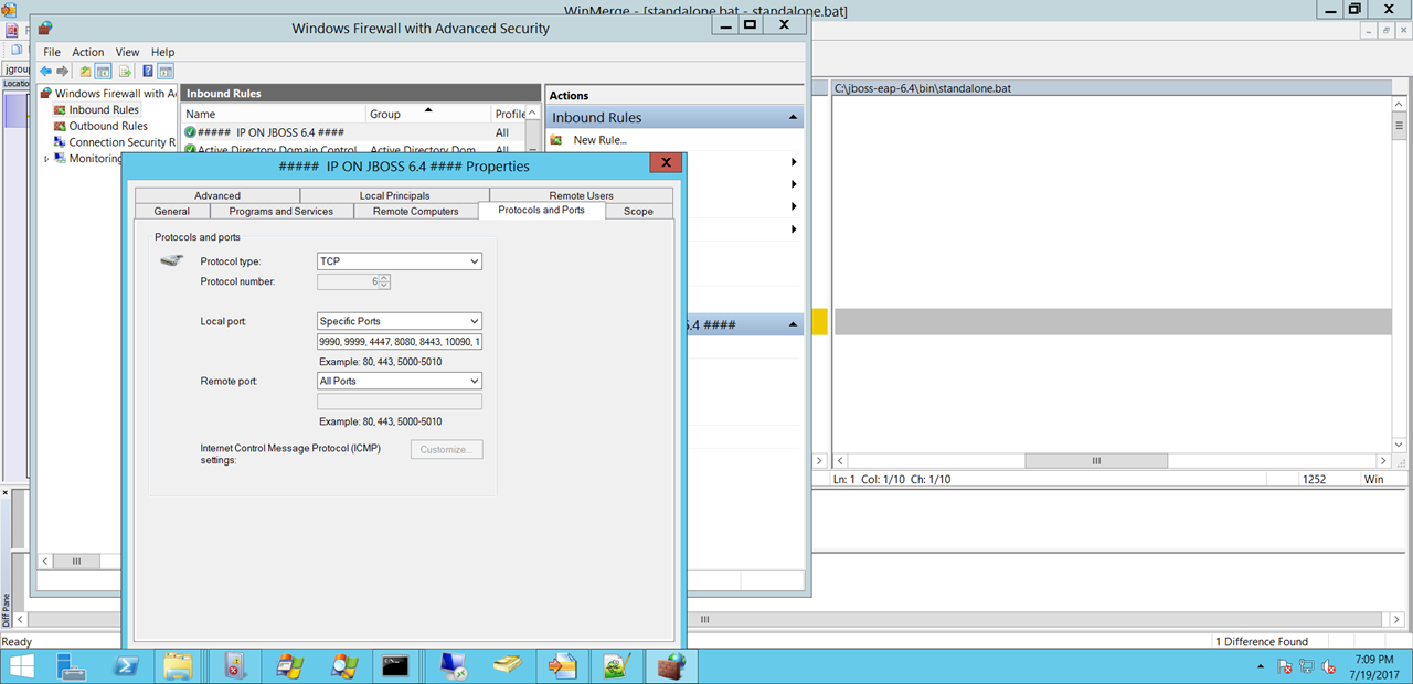

         - Updated OS F/W to avoid blocking ports used by JBOSS/Wildfly:  8080, 8443,9990, 9999, 4447, 7800, 7801

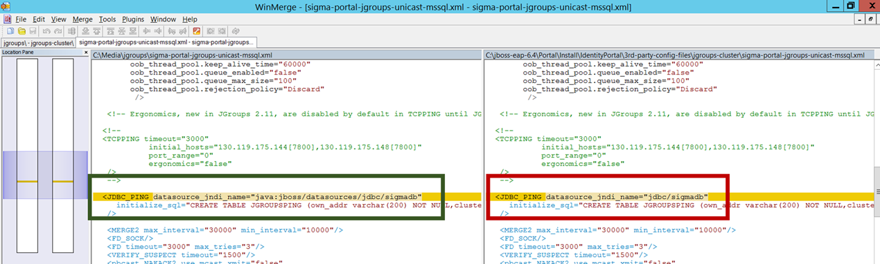

         -  Ensure data source name is correctly referenced in the multicast/unicast XML files
    Step 05) Shutdown JBOSS and updated standalone.xml for unicast, and additional JVM options for standalone.bat
       - Screen shot below
    set "SERVER_OPTS=%SERVER_OPTS% -bmanagement=0.0.0.0 -b=0.0.0.0"
    set "SERVER_OPTS=%SERVER_OPTS% -Djboss.socket.binding.port-offset=100"
    set "SERVER_OPTS=%SERVER_OPTS% -Djboss.node.name=dc2012-2"
    set "SERVER_OPTS=%SERVER_OPTS% -Dsigma.portal.jgroups.tcp.port=7900 -Dsigma.hibernate.jgroups.tcp.port=7901"
    Step 06) Ensure the "reference" unicast/multicast files are sourced correctly with a full PATH
    -  Screen shot below

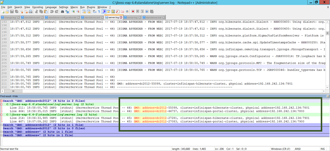

    Validation: Example of a unicast (TCP) cluster with information from server.logs
    MS Windows F/W Ports:
    -  First JBOSS (no offset):  8080, 8443,9990, 9999, 4447, 7800, 7801
    -  2nd JBOSS (offset by 100):   8180, 8543, 10090, 10099, 4547, 7900, 7901
