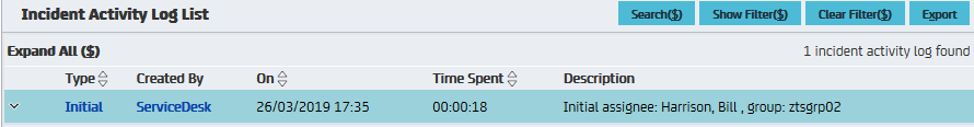

  • 6.  Re: Activity Log - Show Specific Data
    Best Answer
    Posted Mar 26, 2019 05:54 AM
    My approach to option 'b' would be as follows:

    2. Restart Service Desk Manager service and create a new ticket.
    Hope that helps.

  • 7.  Re: Activity Log - Show Specific Data
    Posted Mar 26, 2019 11:23 AM
    James,
    This second one is simple and fantastic.
    I am assuming if I want the log description to say something specific (text from what it used to say (Create a new request/incident/problem/change/issue) plus this new addition (... Initial Assignee: Hainley, Katherine, Group: SSS Service Desk) I just need to change the "sprintf(theMsg," line?
    thank you
    TheKatherine
  • 8.  Re: Activity Log - Show Specific Data
    Posted Mar 26, 2019 09:16 PM
    Hi TheKatherine,
    Glad you like it :-).  That's exactly right.
