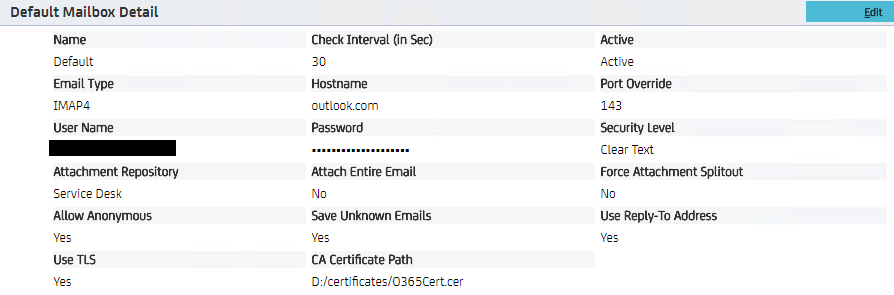

    Bellow is the configuration:
    Can anyone help me to understand what is wrong? What can I do to solve this?

    For the User Name field, are you using the full email address of your Office365 account, or just the username portion?
    Can you confirm if port 143 is open through your firewall / traffic filtering? I've seen similar errors when port 143 was blocked, preventing a connection to the O365 servers.

    Hi,
    I'm using the full email address and the port is open.

    what if you change the certificate path from
    D:/certificates/O365Cert.cert
    to
    D:\certificates\O365Cert.cert
  • 5.  Re: Mail eater error with STARTTLS office365
    Posted Jun 06, 2018 03:34 PM
    Hi,
    Already tried that but didn't work.

    on which server you have
  • 7.  Re: Mail eater error with STARTTLS office365
    Posted Jun 07, 2018 01:29 PM
    I only have one server.
    And the SDM installation is on D: disk
    I also tried the path with // and \\, still got the same error message.
    In the firewall, I've also opened the 993 port.
    Should I change the certificate to another folder?
    What do you suggest?

    Hi,
    I got it only after ran the following command:
    C:\PROGRA2\CA\SERVIC1\bin>pdm_perl pdm_keystore_mgr.pl -import C:\newcertificate.cert
    Generating 2.048 bit RSA key pair and self-signed certificate (SHA256withRSA) wi
    th a validity of 36.500 days
    for: CN=CA, OU=CA Service Desk Manager, O=EITM, L=Islandia, ST=NY, C=US
    [Storing D:\PROGRA2\CA\SERVIC1\pdmconf\nx.keystore]
    Certificate was added to keystore

    Hello all,
    There is a known issue with regards to certificates and Office 365, which has been documented here:
    https://knowledge.broadcom.com/external/article?articleId=198751
