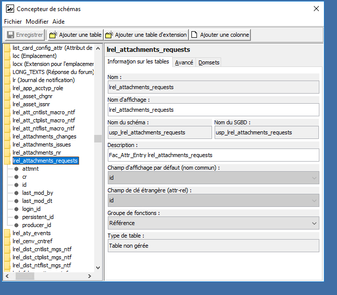

    You need to create an object like this one :
    "lrel" object are used to store n to n relationship.
    Since a CNT can have several attachment and an attachment can be linked to different CNT, it's n to n.
    You will also need to edit xx_atmnt_tab.htmpl to take into account that there is a new object that can be linked to attmnt.
    And even after that, it may not work as I am not aware of all the prerequisite for SDM to start uploading attachment to a new object.
    It is not an easy customization.
