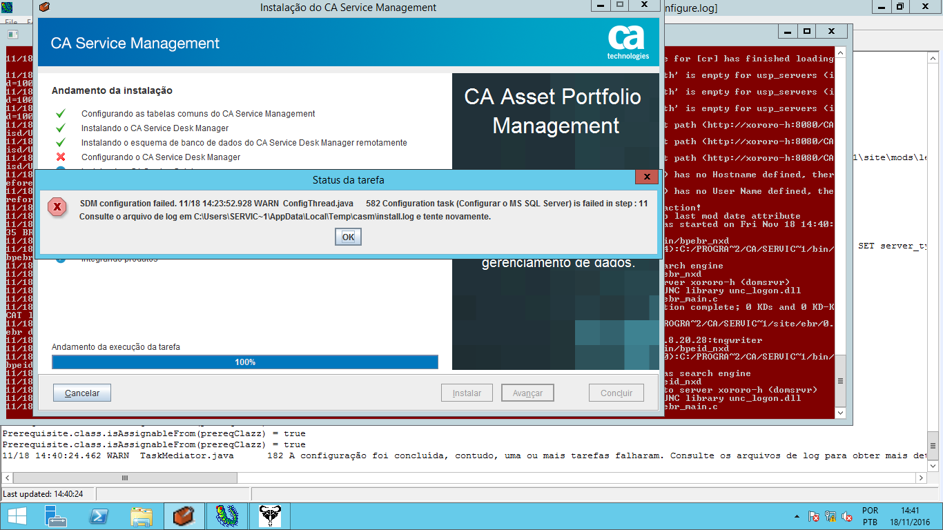

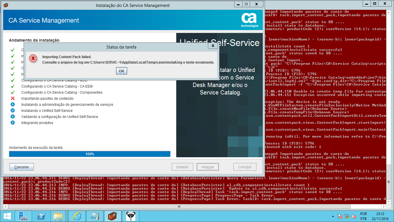

    In my attempts several errors end up occurring, since errors with the installation of CA Service Catalog:
    To erros with SDM configuration:
    At this point I was able to access the mdb backup when I was able to install without errors (also without restoring the database).

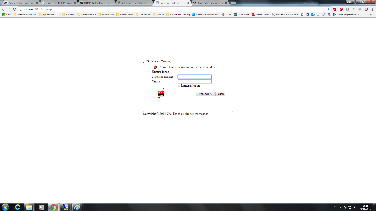

    While writing this topic I was able to install SDM, Catalog, USS and restore the MDB pointing to the new server without several erros, but I still can´t access the CA Service Catalog with the servicedesk user:

    The installation works fine in two of the times I made the settings, in the first one I was able to access SDM, EEM and Catalog without major problems using the servicedesk user with the new password, but this last time an error occurred in the step of integrating products and things are not good now!
    When I access the ca service catalog it appears to me this way:
