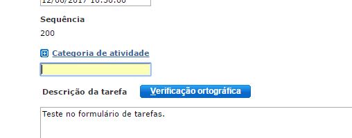

    I've created one new table "z_wf_category".
    I need to create a hiersel search for this new table, so I've created 2 new HTMPL files that I attached on this post.

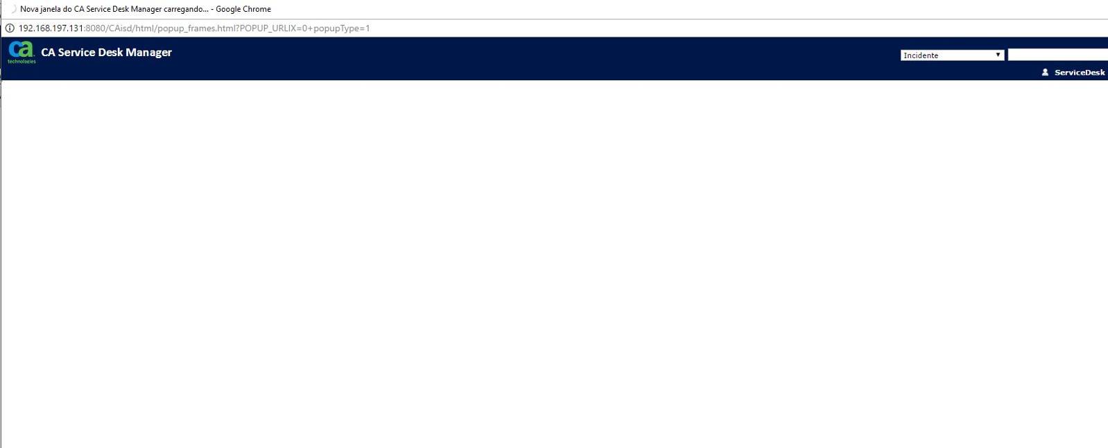

    When I try to use this on detail_wf.htmpl nothing happens.
    Can you guys help me? Did I miss something?

    However, what code was defined in detail_wf.htmpl for header 'Categoria de actividade' ?
    What error message do you see in this case? Do you get any pop-ups at all?
    Check of any of the pop-ups are blocked in your browser!
