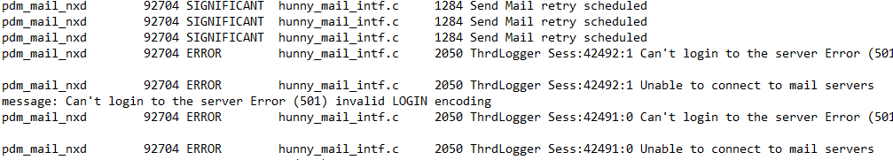

    Hello I have a survey in SDM 1.1 cum 3  and send the URL to answer the survey ,  when I click on the URL od the mail  the following screen appears:
    Investigate the problem and I followed the steps to solve from this url
    Error: "AHD05237:An internal error with surveys occurred." In Browser When Submitting A Survey
    But they do not work  In the log I get the following:
    if anyone knows how to solve this problem please let me know
