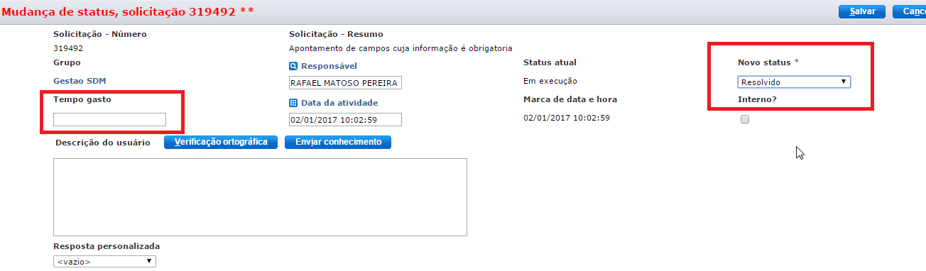

    Hi folks,
    I need the analysts to fill the time_spent field when a certain status transition occurs (eg when the ticket goes to the resolved status).
    I tried to create a condition for this, creating the attribute "alg.time_spent" on the object request/incident/problem and then I associated a rule for him. But, this didnt work.
    Any ideia how i can do it?
    Thanks very much,
    Rafael

    An alternative to a SPEL trigger could be a presave trigger on the form.
    Here's an example from detail_cr.htmpl (requests) which I have written:
    // Function checks that Closure Code is given while resolving (Status => "RE")
    function preSaveTrigger()
      if (document.forms['main_form'].elements['SET.status'].value == "RE")
        if (document.forms['main_form'].elements['SET.resolution_code'].value == "")
          alert(msgtext("Closure Code is mandatory while resolving"));
          // Focus set to Closure Code field
          document.forms['main_form'].elements['SET.resolution_code'].focus();
          return false;
      return true;
    Best regards
    Kimmo

    Hi kimmo.andersson
    Thanks for you support. Its work perfeclty!! Congratulations!!!
    Regards,
    Rafael
