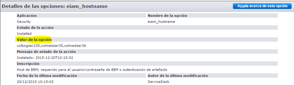

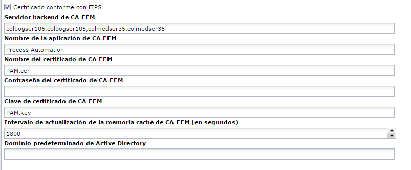

    Actually I have a CA EEM on an failover environment (Process SAML Authentication ) and in SC, SDM an PAM I have configureted 4 CA EEM (failover environment) like this:
    Option Manager on SDM
    CA EEM on PAM
    Now: if the server "colbogser105" crash, all connection from SDM (Connection between SDM Server and CA EEM Server for the authentication)  are redirected to the second server, and if the second server is off##line all connection are redirected to the third server. This Example is the same on PAM.
    My Question is, Can i configure 2 or more CA EEM on CA USS using a comman? like server1,server2,server3

    I did a quick test and I saw that, once you add comma separated EEM hostnames in the USS authentication tab for EEM, you needed to do one fresh USS restart.
    There after, I am able to work with USS without having to restart USS while EEM is failing over fine behind the scenes.
    My tests were with 14.1.02 plus couple of fixes
