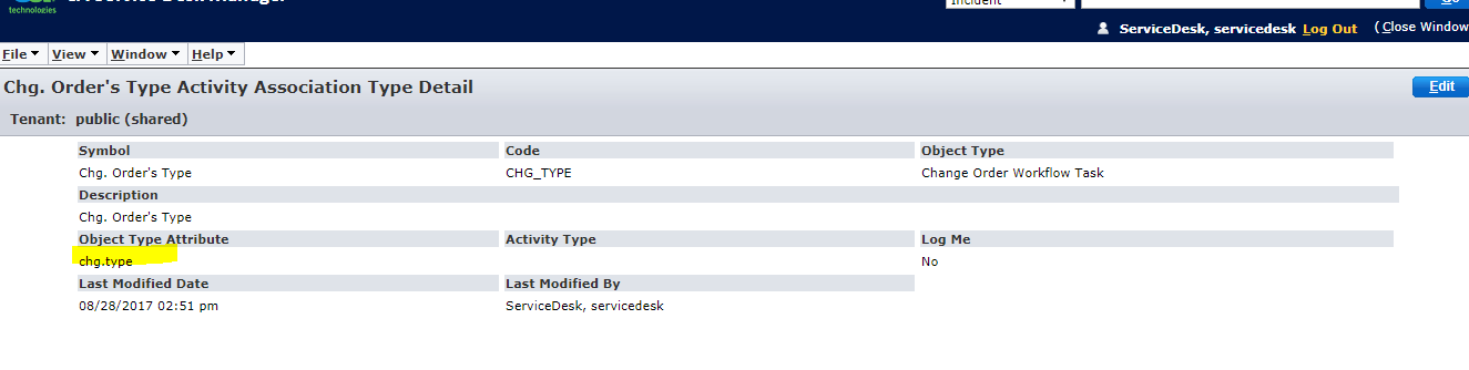

    Hi, thanks to all of you. Can I create a Activity Association for Change order type in the Object Type "Change Order Work Task" I need it for create a site-definition-condition in a behavior for workflow task
    I did the next configuration but this does not work, thanks in advance

    Hi Jon, I have configured a behavior in a workflow task in a particulary category, when the change order is created then the action on te behavior assignee field of the affected contact in te assignee of the workflow task.
    But I don want that this happen if the change order created is of emergency type. (I need to create a site-definition-condition)

    Walter, it should be "chg.chgtype" not "chg.type" for object type attribute. The value for emergency is 300. Thanks _Chi

    It Works, Thanks!
