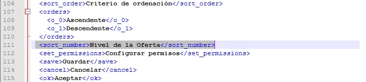

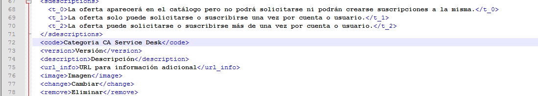

    - The File was modified by a partner so maybe I don't have all the knowledge. I know that they added code in lines 72 and 111:
    The code added "<code>Categoria CA Service Desk</code>"
    The code added "<sort_number>Nivel de la Oferta</sort_number>"

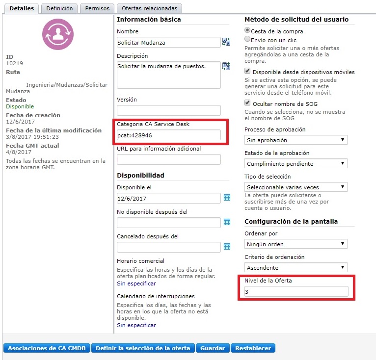

    This changes look like this:
    If I add new lines to the code the changes don't appear.
    The main idea behind this changes is to give the catalog admins an easy way to change some values that changes in each offering. For example, a custom field for the Service Desk pcat value to assign it to the right Incident Area in SDM. Then I can call that value from the form and through javascript send it to SDM.

    The first thing I notice is that you did not add a new line(code) but you changed an existing one.
    Which makes a huge difference.
    So, you changed the text from 'Code' into 'Categoria CA Service Desk' and saved the file.
    Form then on, this new text appears on every offering in SC/Catalog>'offering'.
    Internally however, this field is still recognized as 'Code'.
    Which means that to get the value of this 'Code' field on a form,
    you simply set '$(_.service.code)' in the 'value' of the named attribute 'Value'
    Kind regards, Louis.
