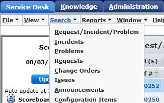

  • 1.  r14.1 Customize Go Button - Search multiple ticket types
    Posted 07-05-2016 11:10 AM
    Reviewing both the ServiceDeskUsers and Tiago MACUL's Blog at:
    http://www.servicedeskusers.com/R12_Go_button_Search_Customization
    I tried to follow the same for r14.1.02 and found that the get_go_sel_arr() function does not exist.
    Has anyone completed this for r14.1?

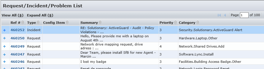

    1. Found the cut-and-paste error in the last update.  The initial blank out of the go_btn row was caused by a CR/LF at the end of the Resource Field.
    2. Corrected the cut-and-paste error for the resource which was causing the double escape error.
    Now, I am left with the result that the search only returns the ticket type if I change the resource to the specific factory
    Requests
    or Incidents
    I've tried using no 'default for Object Type' and also no FACTORY in the Resource and variations on all of those.
    J.W.

    Hi.
    you need to have  your own factory and refer to it in the resource link to have this to work.
    $cgi?OP=SEARCH+SID=$SESSION.SID+FID=123+FACTORY=z_cr_all+SKIPLIST=1+QBE.IN.ref_num=$searchKey
    the factory can be easely created with a mod file like below. Copy/paste the code into below into a factories.mod file and place it in your site/mods/majic folder. Note that you will need to recycle SDM for the change to take effect.
    //used for creating custom factory on object when needed JMayer 101508
    //New factory to display all cr in list disregarding cr type
    OBJECT cr {
    FACTORY z_cr_all{
      DOMSET template_list "template_name" "" DYNAMIC ;
      DOMSET zcrall_list "open_date desc, ref_num desc" "" STATIC;
      STANDARD_LISTS {
       SORT_BY "open_date DESC, id DESC, status, priority DESC, ref_num" ;
       MLIST OFF ;
       RLIST OFF ;
      REL_ATTR persistent_id ;
      COMMON_NAME ref_num ;
      FUNCTION_GROUP "call_mgr" ;
    Note that you will need to create the corresponding htmpl forms for that new factory too.
    just create a detail_z_cr_all.htmpl file with just the code below to redirect to the correct form afterwards:
    <PDM_IF 0>JMAYER 2011/08/14: detail_z_cr_all.htmpl. When we search for all R/I/P we need to reroute to the appropriate factory form</PDM_IF>
    <PDM_IF "$args.type" == "I">
    <PDM_INCLUDE FILE=detail_in.htmpl>
    <PDM_ELIF "$args.type" == "P">
    <PDM_INCLUDE FILE=detail_pr.htmpl>
    <PDM_ELSE>
    <PDM_INCLUDE FILE=detail_cr.htmpl>
    </PDM_IF>
    Proven to work since r11 and up to last r14.1 cp2
    Using that concept and extending it to the list form and menu_sd you can either have a new search in your menu listing all the tickets together
    Hope this help.
    /J

    That was the missing piece.  I had saved the custom factory mod as a .test until I resolved the original issue with the (now) non-existent function and then tried to continue using the suggestions of the standard factories.
    The GO button is working as expected now.  I have not completed the option to allow the same from the Search menu.
    I'm marking jmayer 's response as correct as it brings the discussion around to the beginning; but thanks to everyone who contributed.
