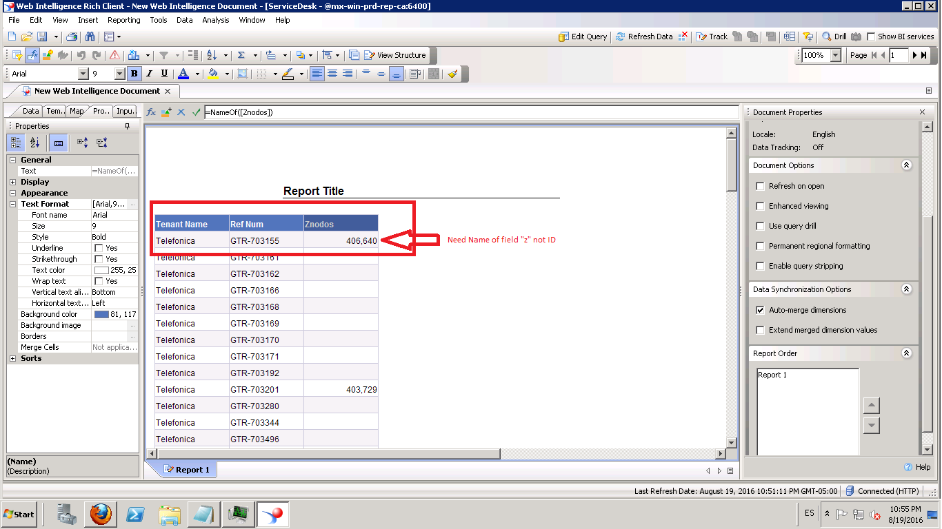

I am working with CA SDM and CABI version 12.9, we need to update the derived universe, to add new z fields.
the fields were added without problems, but when I try to make a report sample information as follows.
we need the name of each record. and not the ID.

You can help me change the format of the information?
because this problem is affecting my production environments.
