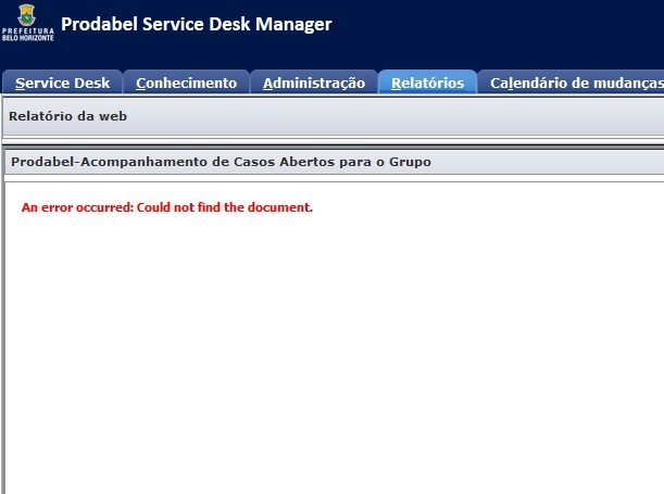

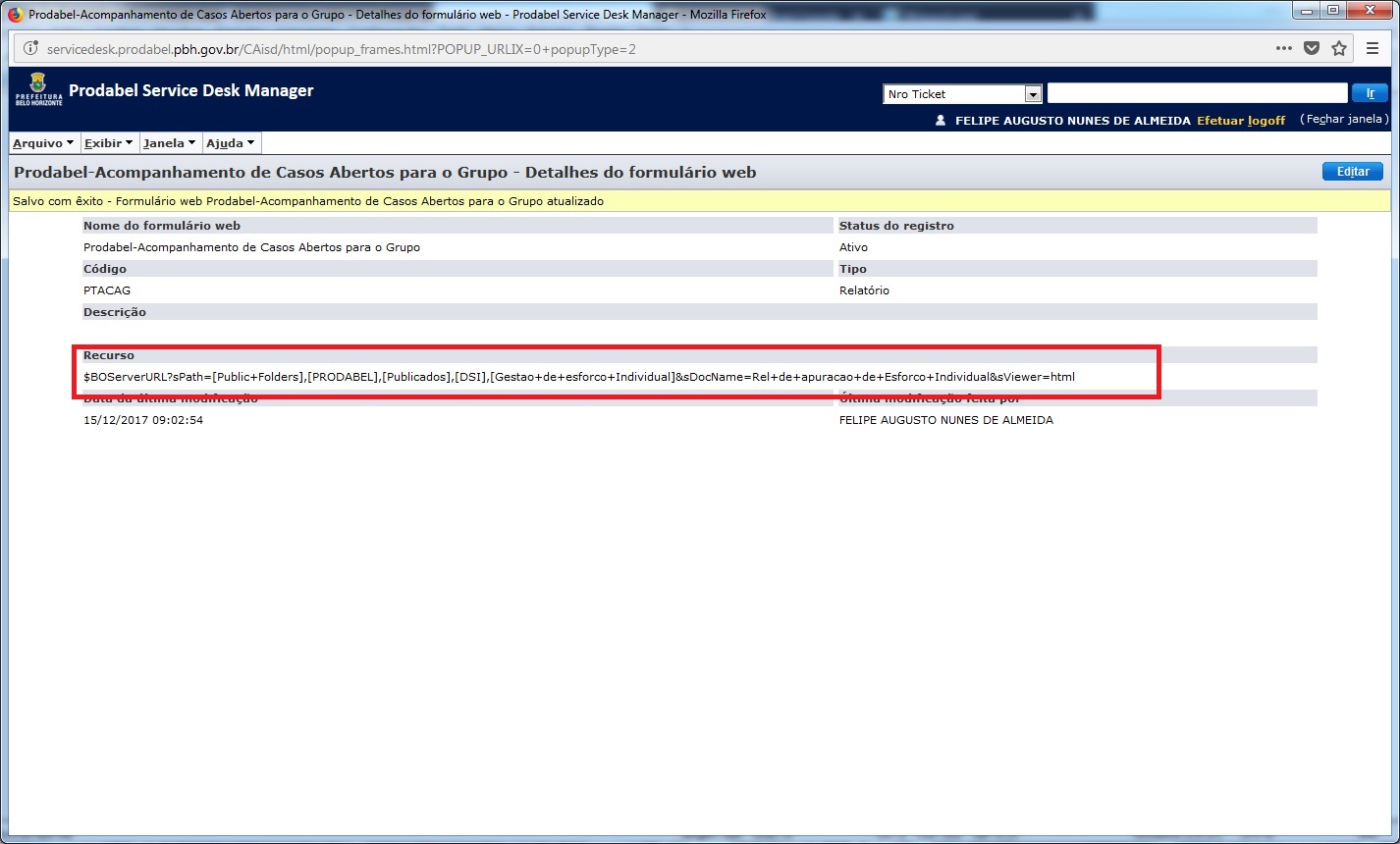

    I'm creating a Web Form to open a report when the user access the report tab on SDM.
    I've created the Web Form:
    Path's report and report name:
    But when I've tried to execute the Web Form, the error occurred:
    I know that is permition, but I couldn't find where is. Anyone knows which permission I have to give to open the report?

    hi
    I don't think you need the [Public+Folders] as this is already the root path

    Felipe.........
    Please try removing [Public+Folders] from the Resource path and see if that makes a difference.

    Hey Felipe.
    As Paul and Jerome mentioned, [Public+Folders] is already part of the root path for reports, so you can try removing that. OOTB we just specify the next folder under Public:
    For Example:
    $BOServerURL?sPath=[CA+Reports],[CA+Service+Management],[CA+Service+Desk],[Change+Order],[Aging]&sDocName=Active+Change+Orders+Aging+by+Priority+for+Categories&sViewer=html

    Posted 12-15-2017 11:11 AM
    First of all, I'd like to thank.
    I've configured as you guys said, removing the [Public+Folders], but still no working. Appears the same error message.
    I guess the error is related with some configuration, because when I execute the web form "Overall Summary" ( I guess this web form is OOTB) , the error doesn't occur. See below:

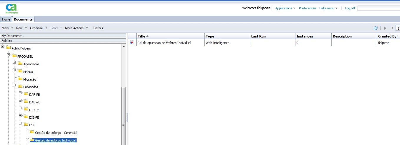

    Please provide a screenshot showing the entire Report Document Library in BOXI Infoview.

    Posted 12-15-2017 12:07 PM
    Paul,
    Sorry about this question, but where Could I find the Report Document Library in BOXI Infoview?

    Felipe.......
    Login to Infoview and select the Document which shows the report folder structure.
    I would like to see how you have the folders setup in CABI.

    Posted 12-18-2017 11:42 AM

    Is It this information?

    Posted 12-18-2017 12:25 PM
    Yes it is - thanks.
    Try placing a copy of the custom report in the OOTB 'CA Reports->CA Service Management->CA Service Desk' folder in Infoview.
    Then update the Report Definition within SDM and see if that changes the behavior

    Posted 12-18-2017 01:28 PM
    Paul,
    The problem was solved.
    We did 2 alters:
    1) remove the caracter "-" from the web form's name
    2) change the report's name to a shorter name.
    After that, the web form has worked at report's tab.
