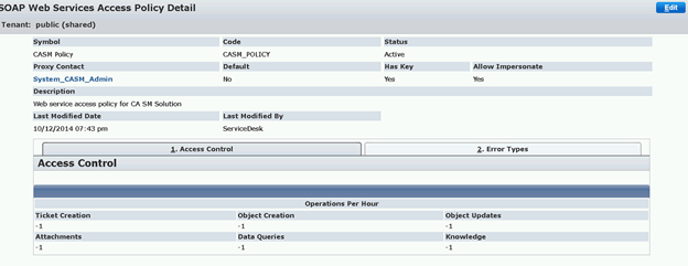

- To create the policy in SDM with the name as set in Service Catalog.
- Go to the Service Desk UI and login as administrator:
- Go to Administration > SOAP Web Service Policy > Policies
- When not existing, click 'Create New' button and set the properties:
- Symbol and Code to CASM_POLICY.
- Status to Active,
- Proxy Contact to "Administrator, Service Desk" (whichever userid is scadmin)
or "System_CASM_Admin" (which userid is CASMAdmin) or any other Service Catalog admin user
- Allow Impersonate to Yes
- other settings can be left as default.
- Click 'Save'. Click 'Close Window'.
- Go to Administration > SOAP Web Service Policy > Policies > Search to verify
Note:
While creating the webservice policy from service desk administration, the "Has key" field is set by default to "No" and is read only.
It is not possible to edit it.
The setting should/will get set to Yes automatically, after you create(d) the policy file itself in the next step.
You can open the policy in SDM to verify this after you created the .p12 file.

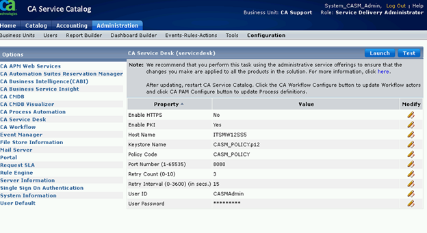

- Lastly, set the SC-properties accordingly.
- Then, back in the Catalog UI logged-in as 'scadmin' user (admin credential login):
- Goto Administration > Configuration > CA Service Desk
- Set Enable PKI to 'Yes'
- Ensure that the Keystore Name is set to CASM_POLICY.p12 (case sensitive)
- Ensure that the Policy Code is set to CASM_POLICY (case sensitive)
- Ensure that the Port Number is set to the SDM-port number
- Ensure that the Host Name is set as the 'single' hostname of the SDM-server
Now the 'Test' should then successfully use the certfile to connect to Service Desk.
