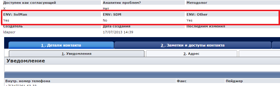

    I have created new control, which is uses integer and can store multiple values, OOTB attribute like this is stored in USP_PREFERENCES and called web_preferences.
    JS control already done and I'm planning to publish it as regular PDM_MACRO, but usablity question can ruin all my plans.
    PDM_MACRO example (based on checkbox):
    <PDM_MACRO name=dtlBitwiseAnd hdr="ENV: SolMan" attr="z_env" key="1" on="Yes" off="No">
    <PDM_MACRO name=dtlBitwiseAnd hdr="ENV: SDM" attr="z_env" key="2" on="Yes" off="No">
    <PDM_MACRO name=dtlBitwiseAnd hdr="ENV: Other" attr="z_env" key="4" on="Yes" off="No">
    How it looks:
    in my example z_env = 5.
    Regards,
    cdtj
