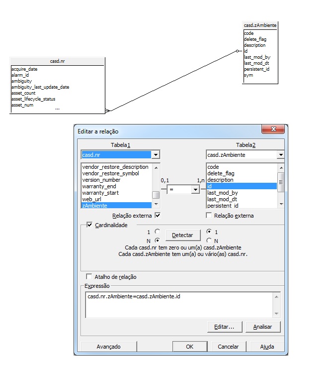

    First, we created a custom universe listing the "NR" and "zAmbiente" objects.
    We enabled "ANSI92" and "SORT_JOINS_BY_QUERY_OBJECTS" on that universe as stated on
    http://www.ca.com/us/support/ca-support-online/product-content/knowledgebase-articles/tec605391.aspx

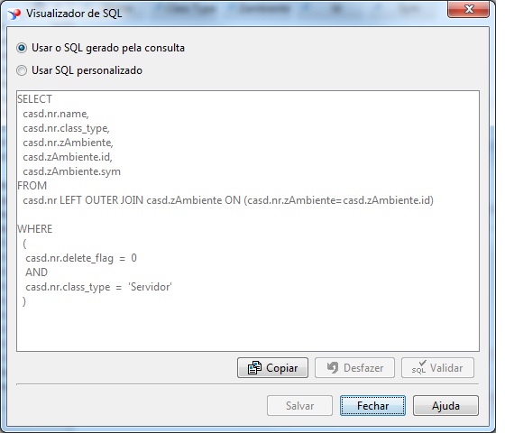

    After applying the relationship between the 2 objects (screenshot1), we looked at the result query on WebI (screenshot2).
    The problem is that the left join does not seem to be working, as the result lists all CIs and all zAmbientes - the ON clause does not work.
    We tried hardcoding the left join SQL in several ways, and none of them seemed to be working as intended. We want the report to show the CI, even if it does not have any zAmbiente related to it (hence the left join being used).
