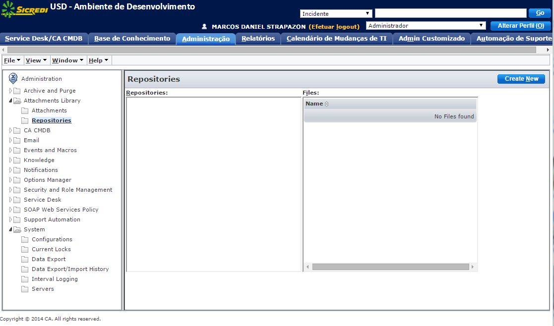

    After upgrading SDM version from 12.7 to 14.1 I can not see the repositories.

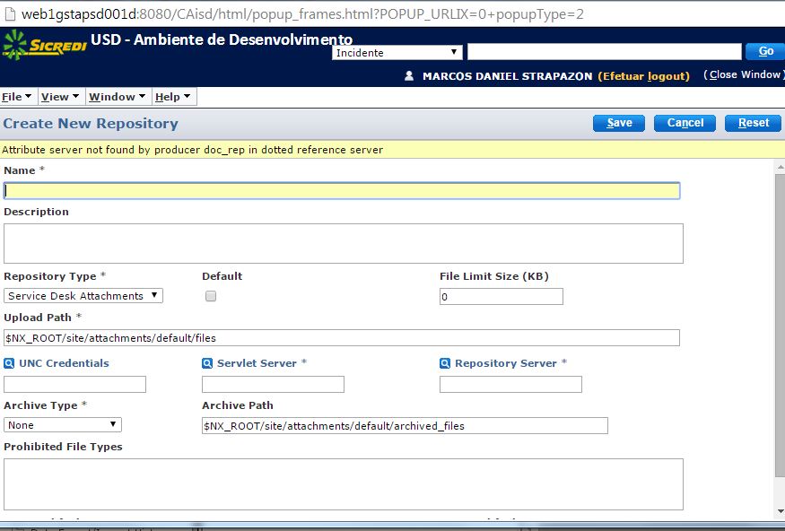

    This very message also appears when I try to create a new repository:
