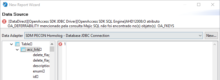

    Hi SteveTroy,
    I've created the Data Adapter for Service Desk in Jasper Studio as you described. However, when I try to create a new report using this Data Adapter, this error happens:
    Is this a known issue? Do you know what may be causing this?

    Hi Jon_Israel,
    You can see the error on the screenshot above (my first comment). This happens when I try to create a New Report using the Data Adapter I've just created (following the steps here). When I drag any table, the following error appears on upper part of the window:
     [DataDirect][OpenAccess SDK JDBC Driver][OpenAccess SDK SQL Engine]AHD12008:O atributo OA_DEFERRABILITY mencionado pela consulta Majic SQL não foi encontrado no(s) objeto(s)  OA_FKEYS at OA_DEFERRABILITY ... AS
    Which means: "OA_DEFERRABILITY attribute mentioned by Majic SQL query was not found in objects OA_FKEYS at OA_DEFERRABILITY ... AS"...

    OA_DEFERRABILITY attribute mentioned by Majic SQL query was not found in objects OA_FKEYS at OA_DEFERRABILITY ... AS"...  typically means that you are not running the correct odjc driver on the SDM server.
    Are you sure you are running version 72 of the ODBC Driver?  Please check and let me know. I've worked on numerous cases were the driver was 60 and not 72.

    Posted Jan 17, 2017 09:10 PM
    The little square blocks that we're seeing next to table/column names seem to indicate that we have OAserver 6.x release on server side?  Is this an SDM upgrade from 12.x by any chance?
    _R

    Hi Raghu.Rudraraju,
    Thanks for your response. About the ODBC Driver, I'm afraid I can't say about the version. How can I check (and correct, fi wrong)?
    About SDM, yes, it's an upgrade from 12.7 version. Is there any issue regarding it?

  • 16.  Re: Jasper Studio - Create Data Adapter for SDM
    Broadcom Employee
    Posted Jan 18, 2017 09:28 AM
    checkout this thread,  upgrading server side ODBC should help out resolve this issue I think.
    https://communities.ca.com/message/241944405?commentID=241944405#comment-241944405

    Posted Jan 18, 2017 01:51 PM
    Hi Raghu.Rudraraju,
    It worked like a charm! Thanks a lot.
