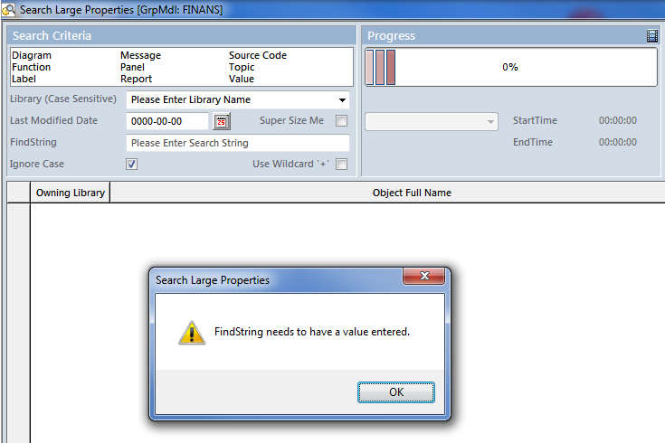

    Normally the dialog should not be have the title "Panel". Please read attached help that includes Lorenz's useful info.
    Specifying the Message Box Title (Windows Only)
    By default the text appearing on the title bar of a dialog or enquiry message box is the title of the panel that sends the message or the name of the sending function, if there is no panel. You can override this text by entering a title in the
    [Message Box] section of the application's .INI file:
    [Message Box]
    Title=My Application
    Always Override=False
    In this example, the title text My Application is used for all messages, except where a FNC name NME triple has been specified for the sending function. In this case, the specified name is used instead. Set the Always Override option to True if you want the title text specified in the .INI file to be used in all cases.
    And if you use the manifest you will get a dialog that looks like the follwoing BUT it does mean your whole application will look different...I have tried the manifest change with success on new dev but changing an existing application involved work and user acceptance
