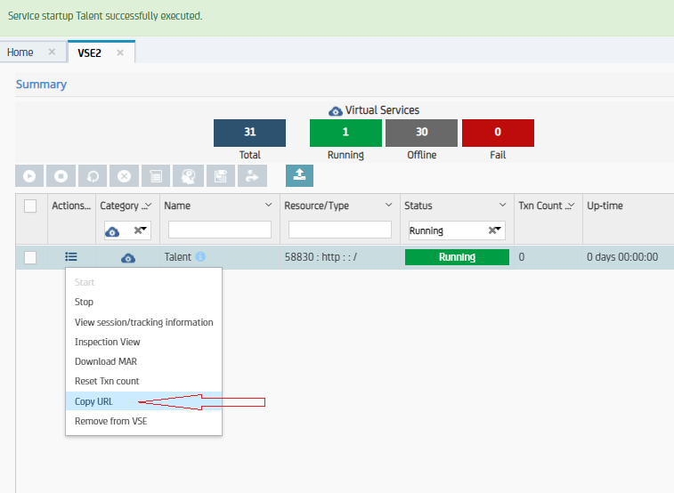

    HI Thulasi
             Yes you can test the VS from all tools like postman, SOAPUI, your own applications under development, CURL commands and even form DevTest Testcase etc.
    You can get the URL of the running Virtual Service from Portal VSE-> Monitor as shown below:

  • 7.  RE: What are the different modes of accessing a deployed virtual service
    Posted 2 days ago
    Hi Sankar,
    where to find the URL you showed in DevTest portal, in DevTest workstation?
    regards
    Thank You
    Thulasi
  • 8.  RE: What are the different modes of accessing a deployed virtual service
    Broadcom Employee
    Posted 2 days ago
    Hi Thulasi
             That screenshot was from Portal.
    regards
    Sankar Natarajan
    This electronic communication and the information and any files transmitted with it, or attached to it, are confidential and are intended solely for the use of the individual or entity to whom it is addressed and may contain information that is confidential, legally privileged, protected by privacy laws, or otherwise restricted from disclosure to anyone else. If you are not the intended recipient or the person responsible for delivering the e-mail to the intended recipient, you are hereby notified that any use, copying, distributing, dissemination, forwarding, printing, or copying of this e-mail is strictly prohibited. If you received this e-mail in error, please return the e-mail to the sender, delete it from your computer, and destroy any printed copy of it.
  • 9.  RE: What are the different modes of accessing a deployed virtual service
    Posted 2 days ago
    Hi Thulasi,
    In devtest portal, Once you login -->  Select Monitor, Virtual Service Environments in the left navigation menu.
    Select the virtual service, click on actions options to get the copy URL option.
    Thanks
    Regards,
    Vaibhav Jain
    Capgemini

  • 11.  RE: What are the different modes of accessing a deployed virtual service
    Posted 2 days ago
    Hi Thulasi,
    You will not find the entire url in the workstation (VSM). However, using the details in Listen step, you can create a url as below
    http(s)://VSEHOSTNAME:ServicePORT/BASEPATH
    ServicePORT & BASEPATH are available in Listen step in VSM.
    Thanks
    Regards,
    Vaibhav Jain
    Capgemini
