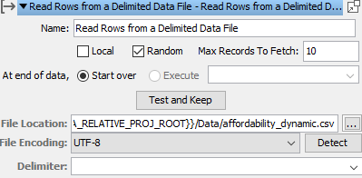

    Then add a "Read Rows from Delimited Data File" dataset to your "VS Image Response Selection" data step, with following definition:
    - File Location: Select the above create file as File location,
    - Set the dataset as: Random
    - Max records to Fetch: 10
    - At End: Start Over

    1. First, I notice you created your CSV file within Excel. If so, have you checked how it looks when you open it as a text file? Make sure it looks like this:
    DynamicThinkTime;
    300;
    300;
    300;
    600;
    600;
    900;
    150;
    150;
    150;
    150;
    I had much more than 10 rows initially (lots of empty rows) when I opened the Excel created file. Also make sure you set your delimiter character correct in the Dataset definition, it has to be a semicolon.
    With the above data file the following dataset definition works for me:
