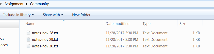

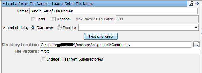

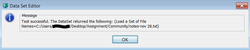

    This Dataset is typically used in the scenario where you are using the files in a directory as an input of the test case for e.g. Sending a file to application that will consume the file and process it and generate response. In that scenario, you might have different files for different test cases.
    It will pick input file from the directory on the basis of File Pattern and will run your Test Step/Case for all the files in directory matching the pattern as shown below:
