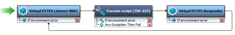

    There may bean easier way to do this.

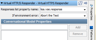

    I added the following as a JSR-223 and let the Responder send lisa.vse.response.
    import com.itko.lisa.vse.stateful.model.TransientResponse;
    import com.itko.lisa.vse.stateful.model.Response;
    import com.itko.util.ParameterList;
    import java.util.List;
    import java.util.ArrayList;
    // set up a response and add a body
    Response rsp = new Response();
    rsp.setBody( "ABCDE" );
    // add HTTP response meta data values
    ParameterList metaData = new ParameterList();
    metaData.addParameters("HTTP-Response-Code=200&HTTP-Response-Code-Text=OK&Content-Type=application/xml");
    rsp.setMetaData( metaData );
    // set a 100ms think time
    rsp.setThinkTimeSpec( "100t" );
    // add response to a response list and convert it to Transient Response list
    // then place it in the lisa.vse.response list object
    List lst = new ArrayList();
    lst.add( rsp );
    testExec.setStateValue("lisa.vse.response", TransientResponse.convert( lst ) );
    // display output of access vse response list to return data set by routine
    return "response body is: " + testExec.getStateValue("lisa.vse.response").get(0).getBodyAsString() +
    "\r\nMetaData is: " + testExec.getStateValue("lisa.vse.response").get(0).getMetaData().toString() +
    "\r\nThinkTime is: " + testExec.getStateValue("lisa.vse.response").get(0).getThinkTimeSpec();
    Service Model:

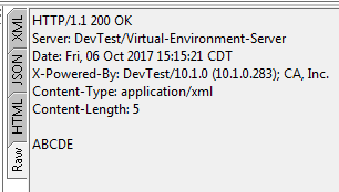

    Raw REST Call Output:
