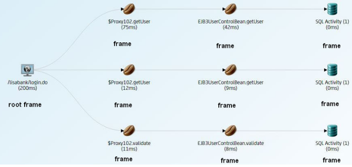

    2) One of the capabilities of the CA InsightAgent is the ability to capture and store the request / response data for transactions in a flow and generate various artifacts.  In the graphic below, consider that S1 is analogous to "root frame" and the subsequent "frames" are analogous to calls to S2 and S3.
    If the test case fires S1 ("root frame") and the Insight Agent captures the R/R data for S2 and S3, the ability to understand the makeup of the request/response data at each step increases.  If the call to S1 fails in DevTest, the information collected by the Agent enables testers and developers to review the input and output at the various steps in the captured flow.  Since the actual R/R data is captured, the input can, in theory, be replayed by sending the data to S2 or S3 independently and verifying the results.  Likewise, since the response data is captured, it can be reviewed to determine possible error situations.   As an aside, you would need to determine if your licensing allows for the use of the Insight Agent.  And, the Agent needs to be active on each of the App Servers where transactions are occurring to generate a complete mapping of the flow.  There are several demos available on this subject if it seems like a good approach.
