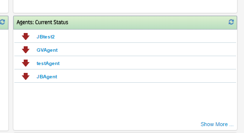

    I don't understand Why I have this message.
    The agent is visible and in the data base but not running....
    TY for your help

    The agent's log file looks good as it says that it was able to connect to the broker and to retrieve rules.xml file from broker and starts dispatching. The other log file does not seem to be related to the problem, because its log entries are from Dec, 13th and 14th, while the agent started on Dec, 15th. You may want to check on the log file pfbroker.log on your registry/broker system for any errors or symptoms.
