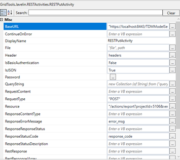

Hi,
I want to execute TDM EXPORT [TDMModelService] Api through Javelin.
This Is how I'm executing the API after creating a authentication token, that is being passed into headers.
baseUrl: https://localhost:8443/TDMModelService/api/ca/v1/objects/33960
resource: "/actions/export?projectId=5106&versionId=5107"
While executing this API through Javelin, I'm getting this error. As per my understanding it is because of resource in that '&' symbol is creating error while parsing.
Can you please suggest something for this, and how to export the JSON files successfully using Javelin?
