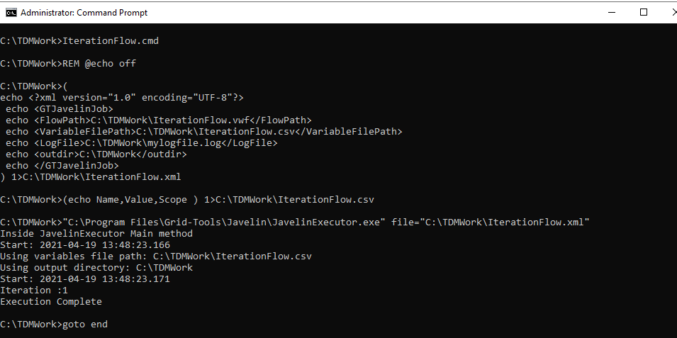

REM @echo off
if [%1]==[] goto error
if [%2]==[] goto error
echo ^<?xml version="1.0" encoding="UTF-8"?^>
echo ^<GTJavelinJob^>
echo ^<FlowPath^>C:\TDMWork\IterationFlow.vwf^</FlowPath^>
echo ^<VariableFilePath^>C:\TDMWork\IterationFlow.csv^</VariableFilePath^>
echo ^<LogFile^>C:\TDMWork\mylogfile.log^</LogFile^>
echo ^<outdir^>C:\TDMWork^</outdir^>
echo ^</GTJavelinJob^>
) > C:\TDMWork\IterationFlow.xml
echo Name,Value,Scope
) > C:\TDMWork\IterationFlow.csv
echo "iteration","%1","Flowchart"
) >> C:\TDMWork\IterationFlow.csv
echo "i","%2","Flowchart"
"C:\Program Files\Grid-Tools\Javelin\JavelinExecutor.exe" file="C:\TDMWork\IterationFlow.xml"

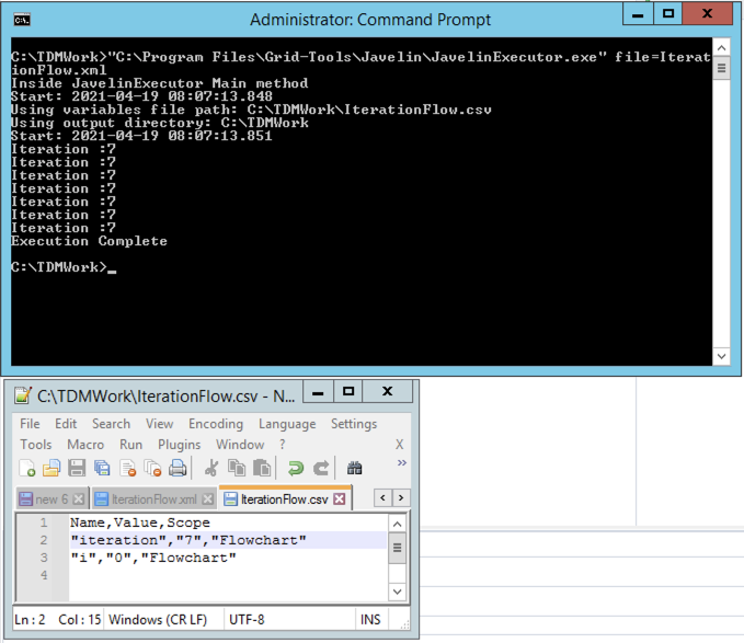

Could you please try with that one?
Run as "IterationFlow.cmd 8 0"
8 > Iteration count
0 > value of i which iteration should start

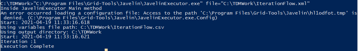

I am using 4.9.155 Javelin version. I tried with admin cmd prompt, but still no luck.

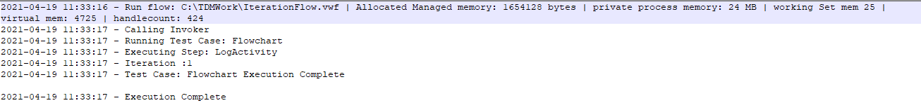

I have executed the sample setup shared, and see the same behavior as that of earlier. (loop getting executed for the parameter configured in workflow, rather than the argument at runtime). In this case, I have the iteration as 1 in the workflow and 3 in the CSV input file. Perhaps, it is not loading the configuration file correctly with the argument value, despite being able to access file/path C:\Program Files\Grid-Tools\Javelin\JavelinExecutor.exe.Config.?
logfile:
