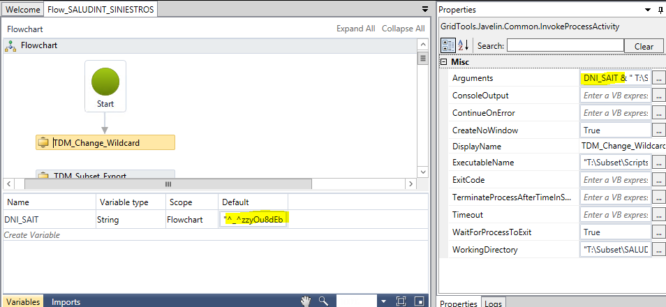

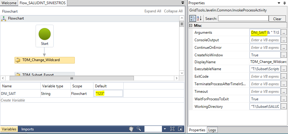

    I would like to know about Javelin Encryptation because If I Encrypt a variable and then I execute the parameters, It does not work.
    Only if I do not encrypt the variable, the javelin workflow works fine.
    Next It does not work
    Next it works fine
